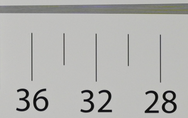

Nikon Z7, JPEG, 105 mm, f/2.8

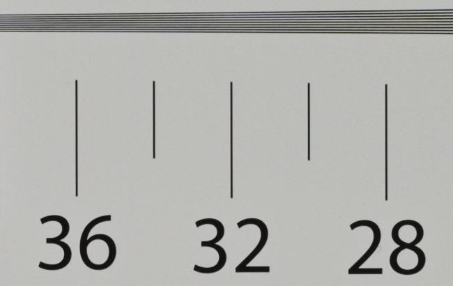

Nikon Z7, JPEG, 105 mm, f/4.0
